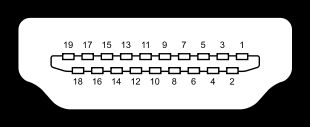

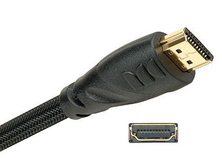

Złącze HDMI
Opis pinów złącza HDMI:
Pin 1 TMDS Data2+
Pin 2 TMDS Data2 Shield
Pin 3 TMDS Data2–
Pin 4 TMDS Data1+
Pin 5 TMDS Data1 Shield
Pin 6 TMDS Data1–
Pin 7 TMDS Data0+
Pin 8 TMDS Data0 Shield
Pin 9 TMDS Data0–
Pin 10 TMDS Clock+
Pin 11 TMDS Clock Shield
Pin 12 TMDS Clock–
Pin 13 CEC
Pin 14 Reserved (N.C. on device)
Pin 15 SCL
Pin 16 SDA
Pin 17 DDC/CEC Ground
Pin 18 +5 V Power (max 50 mA)
Pin 19 Hot Plug Detect
